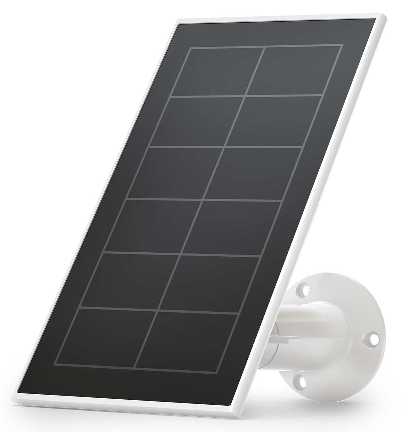

VMA7600 Universal Solar Panel
The VMA7600 Universal Solar Panel works with the following Arlo cameras:
  • Essential Security Camera 2K/HD (3rd Gen) (VMC3080 and VMC2080)
  • Essential XL Security Camera 2K/HD (3rd Gen) (VMC3082 and VMC2082)
  • Essential Outdoor Camera 2K/HD (2nd Generation) (VMC3050 and VMC2050)
  • Essential XL Outdoor Camera 2K/HD (2nd Generation) (VMC3052 and VMV2052)
  • Essential Camera, Essential Spotlight Camera, XL Spotlight Camera (VMC2020, VMC2030, and VMC2032)
  • Ultra Security Camera 4K (3rd Gen) and Ultra XL Security Camera 4K (3rd Gen) (VMC5050 and VMC5052)
  • Ultra and Ultra 2 (VMC5040)
  • Pro Security Camera 2K (6th Gen) and Pro XL Security Camera 2K (6th Gen) (VMC4070 and VMC4072)
  • Pro 5 (VMC4060P)
  • Pro 4 (VMC4041P and VMC4050P)
  • Pro 3 (VMC4040P)
  • Pro 3 Floodlight Camera (FB1001)
  • Go 2 (VML2030)
The VMA7600 Universal Solar Panel uses adapter cables for USB-C, Micro-USB, and Magnetic charging.

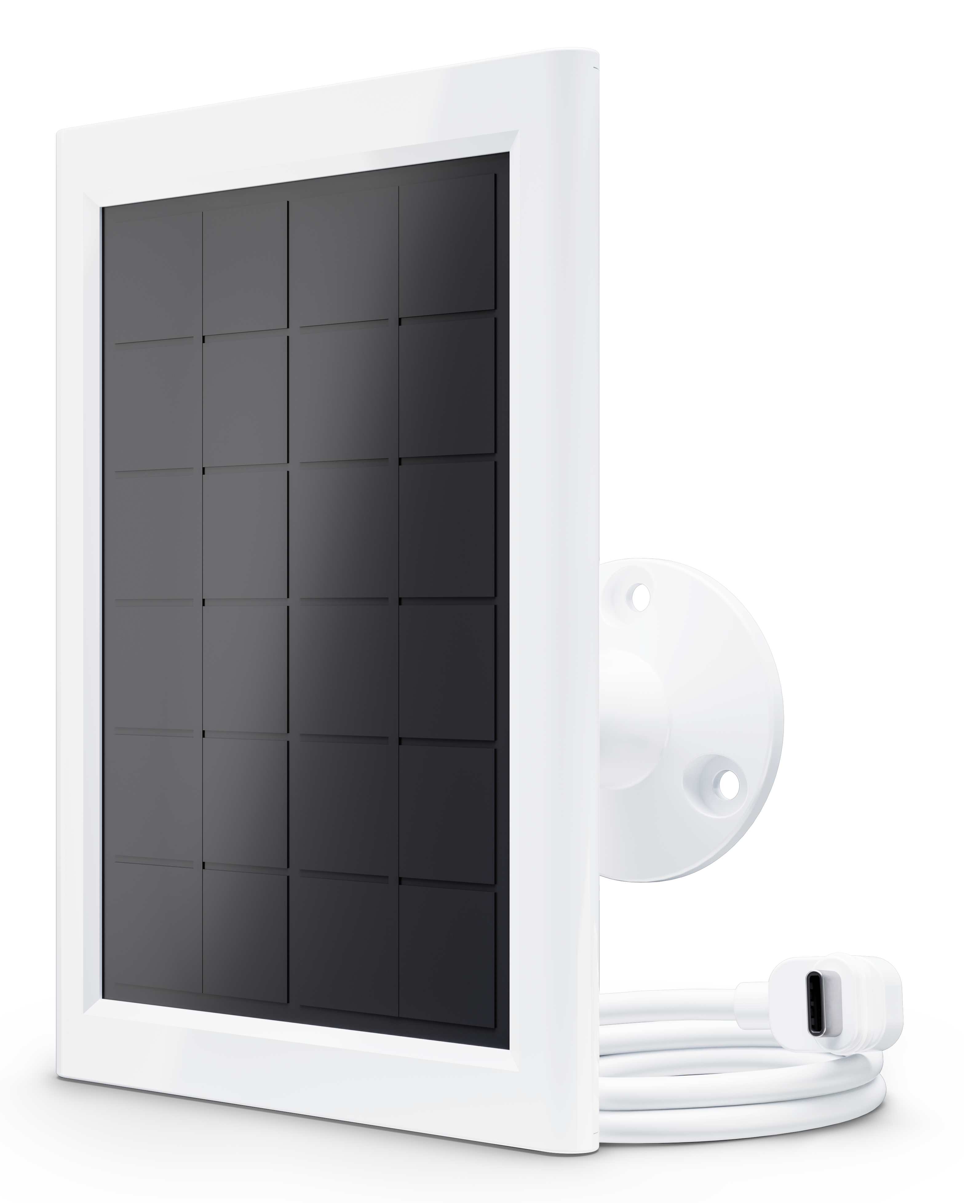

VMA6600 Essential Solar Panel (2nd Generation)
The VMA6600 Essential Solar Panel (2nd Generation) works with the following cameras:
  • Essential Outdoor Camera 2K (2nd Generation) VMC3050
  • Essential XL Outdoor Camera 2K (2nd Generation) VMC3052
  • Essential Outdoor Camera HD (2nd Generation) VMC2050
  • Essential XL Outdoor Camera HD (2nd Generation) VMC2052
The VMA6600 Essential Solar Panel uses a USB-C connector.
